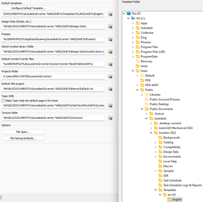

The basic templates new part command is creating a part with centimeter units from an inch part template. How is this possible when Configure Default Template window is set to inches and the template itself is set to inches?
Thank you for your help.
Document settings after creating a new part
Document settings of the Standard part file

  1. The mapped location for templates in the project is C:\Vault\System\2022\Inventor\Template
This location is the advanced template path as seen on the home screen.
  1. I opened the default template part file, Standard (in).ipt from the public documents path the one shown in the first group of screen shots. The units are set correctly to inch.
Is the Basic template location different from the default template location set in Application Options? In other words, where would I Save Copy As Template, to replace the Basic template?
Thank you
Message 5 of 9
alewis
Thank you for your response.
I checked the Configure Default Templates and the units are set correct.
And I’m uploading the standard part file from
C:\Users\Public\Documents\Autodesk\Inventor 2022\Templates\en-US\English
Thank you

“Do you have a template in your folder called "Standard.ipt", without a unit designation?”
No, the folder as shown in the image above only has the “Standard (in).ipt” The template folder location as shown in the Application Options is in the “English” folder inside of the public documents folder. So, I don’t know where the centimeter designation is coming from.

The Configure Default Template is the solution. I configured the default template to be Millimeters then configured again switching back to Inches. Here is what I observed using the Configure Default Template button:
  1. Saves a copy of the current template set. All the standard part and assembly files are copied to the “OldTemplates” folder. This is copied to 2 Template locations.
    1. Public Documents
    2. Project template location
  2. Copies the original template set from the “English” folder of the Public Documents folder. All the standard part and assembly files are copied to 2 Template locations.
    1. Public Documents
 Conclusion
Creating a new part from the Basic area of the home screen now creates a new part with the inch designation. This still leaves the mystery of where the centimeter units’ designation was coming from.
