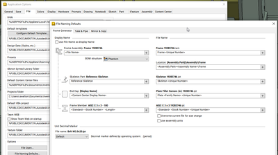

Are you using Frame Generator to create parts?  If so have you made any changes to the file naming defaults? Can you find a combination that gives a unique filename for every placed length?

Vault renumbering is turned on. It works in all other instances well. But not when the part is not in vault yet. I need a numbering tool before it goes into Vault.
