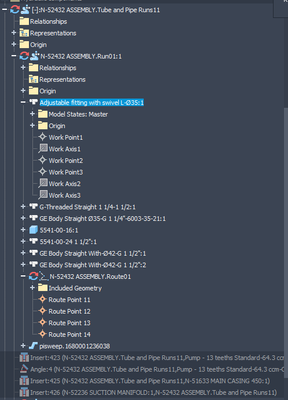

I guess I've added the elbow wrong? Tried everything I could think of, but can't get this done correctly.
The elbow (named "Adjustable fitting with swivel" in my model tree) is not constrained, but placed as a hydraulic part with the connections.
(I know this below isnt exactly the same problem I asked about initially, but its based on the same issue that the elbow doesn't rotate).
Here I've created the first segment manually, and would like to auto route to the elbow.
It technically does what I tell it to do, but I would like it to rotate and only add 1 segment + 45° bend.
It's doing this weird route because of segment/radius rules for the tube, but just a few degree of rotation would reduce it to 2 segments.

Thanks for the added details.  In these new images, I can see what you are trying to do.  Since you connected the elbow directly to another fitting, which is then connected directly to your equipment (tank?), the angle of the elbow will drive the route instead of the route driving the angle.
Are you using a rigid piping style with fittings?  Or is this tubing with bends?

Yes, this is between the oil tank and oil pump.
It is an elbow connected to a fitting, both as within the Pipe Run sub-assembly.
I didn't constrain the elbow to any angle, but it has the Pinned icon (as if its grounded or fully constrained). How can I make the elbow-angle dependant on the pipe instead of vice versa?
Its tubing with bends. Values are gathered from our pipe guy.

To make the elbow respond to the route angle, it would need to be a "populated" elbow automatically placed on a bend in the route.  Unfortunately, for your placement, that would require that there be a short segment between the elbow and the fitting on the tank.  The direct connection there cannot be done in the routing environment... kind of a shortcoming of the way the software works.
If you are using rigid piping with fittings (not bent tube), my suggestion would be to place the elbow manually in a normal position (perpendicular to X, Y, or Z), then Edit Fitting Orientation, and move it to a 45-degree rotation toward your route.  Then you should be able to route between the elbow and whatever the connection is on the other end.  This assumes that your Style has a 45-degree elbow defined.  If it does, it would automatically populate that at the bend.
