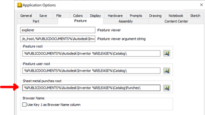

@MatsNorway1
Check under Application Options\iFeature\Punch Tools. Can you share a picture of what is in this path?

Frederick_Law
So you need a hole and emboss.
Model that and you can make it iFeature or Punch.

Frederick_Law
Did you copy the files in the original iFeature\Punches folder?
Message 7 of 12
MatsNorway1
No, as pr installation not including Vault setup.
‌:nauseated_face: ‌:face_with_medical_mask: Fusion 360
Message 8 of 12
Frederick_Law
Well, with no files in there and you expect to find something in an empty folder? 🙄
The folder setup in your IV is not default installation location.
User or Admin need to copy the correct files there.

I am the user, i have admin rights. I can/could fix this with a tutorial that makes sense. If i get the time.
Hmmm, you need tutorial to copy files from one folder to another? 🤔
Someone (user or admin) set a new folder location for the Punch (iFeature) and did not copy the required files.
