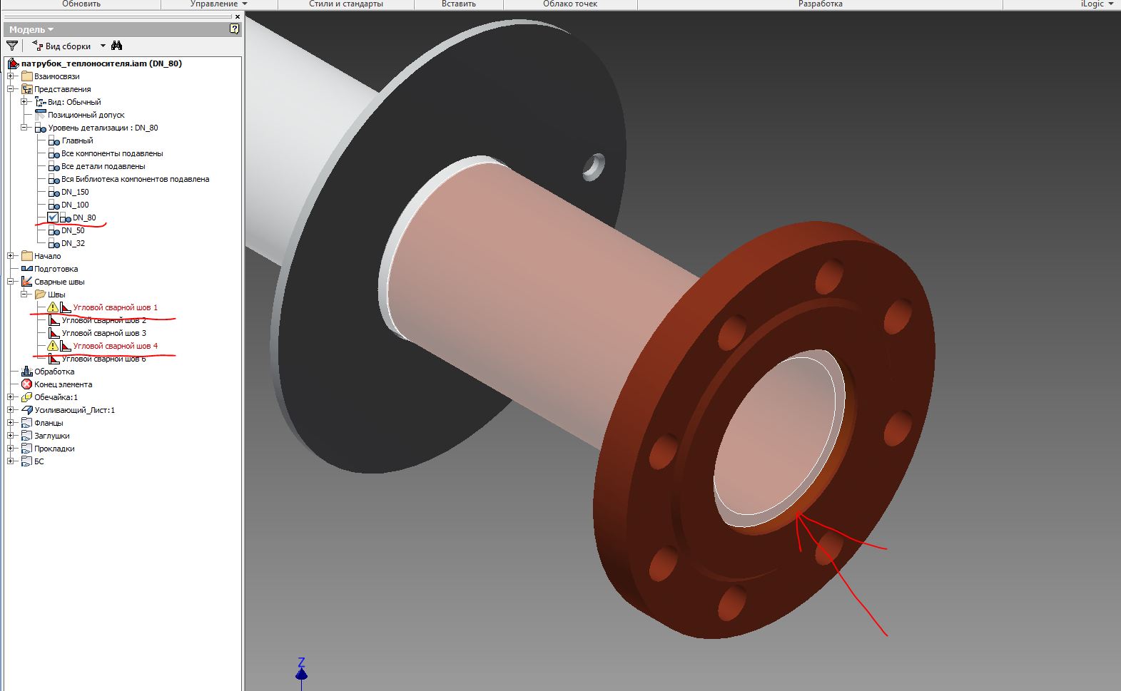

here's the problem:
i have a few noozles of a similar type, with a range of diameters, and i want all of them in one assy.
So i made an assembly and a rule that activates a certain LOD in accordance to parameter change.
I also needed to place a welding between some elements in the assy as shown on the screenshot.
so i've placed it and switched toanother LOD, and to my surprise it disapeared!
i've tried to suppress weld seams in diffferent LODs - but they're not connected anyhow((
also i inspected Rule manager - whether there are any parameters that can control welding - but no, none of them!
so what should i do now to have my welding in different LODs??
Inventor_pro_2015

Hi! I am not sure if there is a supported workflow here. LOD is a memory management tool, not a design altering tool. In theory, assembly constraint and assembly geometry should not be affected by change in LOD, since cached geometry is used to compute assembly constraint or feature in LOD when a part is suppressed (unloaded).
I suspect one of the weld beads is created on cached geometry in one specific LOD state. When another LOD is active and the cached geometry is no longer available, the weld bead fails to compute. Could you attach an example showing the behavior here or send it to me directly ([email protected])?
I would like to understand the behavior better and see if there is a better workflow to fulfill the requirement.

jtylerbc
Johnson,
In general this statement is true, but mcsumkin is using the one exception I am aware of.  When you use iLogic's "IsActive" function to control design configurations, you end up with LOD's just like you would from Suppressing a part.
mcsumkin,
 would it be possible for you to structure this with your welded-together parts as subassemblies, and have the iLogic code swap out the subassemblies instead of swapping out the individual parts?  I don't know if that defeats the purpose that caused you to set this up in the first place, but it seems like it would be a way around this particular problem.

From my side I'll try to describe a problem here In a greater detail:
So, i have a cylindrical, steel (welded, and made of metall plates) storage tank. It has different openings on a side of a shell like manholes and nozzles. The set and qty of them may vary from one to another, as well as their diameter.
Each nozzle consists of: Shell (pipe), reinfocement plate, flange (or two, on the both sides), gasket, blind flange, and a bolted connection.
Flanges are welded to shell, as well as the reinforcement plate - you can see it on the picture i attachaed above, or if you'll reach the files.
I decided to make some kind of a universal assembly, that i can control from my external excel file, where i can specify things like diameter of the tank, diameters of nozzles, thikness of a plates that shell made of, and etc., and that in the end - could give me the final assembly with the set of nozzles that i need for a specific tank.
made couple of rules for a nozzle shell and a reinforcemnet plate, to describe their behavior in case of nozzle diameter or a tank diameter variation (it wasn't very hard), and decided to have all the needed flanges, gaskets and blind flanges in one assembly to activate one of them, and suppress another in accordance to a parameters change.
So when I'm switching LODs, nozzle shell and a reinforcement plate are still the same, so the weld seam between this two elements stays where it was, but flanges are replacing with another one - and welding there fail to compute.
After all, i made another assembly, in which i'm going to gather all the subassemblies of the nozzles and switch them "on" and "off" in the desired sequence, as well as specify their Location.
M.b. i should go the way that John had suggested, and create an assembly for every specific variant of a nozlle. but in this way i can't figure out how can i manage them later in the "fina" assembly. i mean switch them on or off, replace one with another.

I don't think I'm going to have time to dig into it far enough to need the files.  But one more thought based on your latest post - I've never used it, so I can't give much guidance on it, but I'm pretty sure there is a way to use iLogic code to change the active member of an iPart or iAssembly.  If you can look into that, you might be able to use it very similarly to your original idea of controlling LOD's with Parameters.  You would just be switching iAssembly members with Parameters instead.

well probably you're right, and i have to use i-rules to change the active members of the assembly. I've tried a bit to assemble my nozzles this way yesterday, and finded out that ilogic can control "row changing" in iparts, but only for a "non-lirary" parts.
In my case i use 50% of library parts, so i think my way is to create some assemblies with needed variations, and try to make ilogic to replace an assembly file in accordance to a parameter change - trying to figure out how to do it right now.

As a summary i deсided to make a multiple subassemblies of the variations needed, to exclude possible problems with welding and conctraints in the higher level assemblies.
