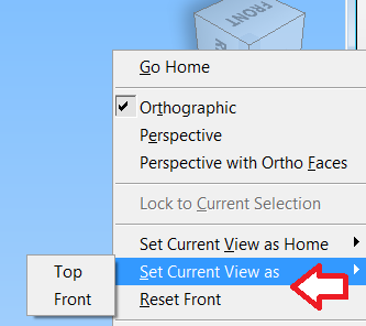

Also, once I get this view, I want to choose it as the new FRONT view, and then update all the remaining std views.  How to do this in Inventor?

I can appreciate that I can flip it in the drawing, but I still want to know, Can I update the "front view" in the part file to the view of my choosing?  If this is possible it just makes everything else better.

JDMather
I think the answer to that is only - maybe.
Right click on the View Cube.
