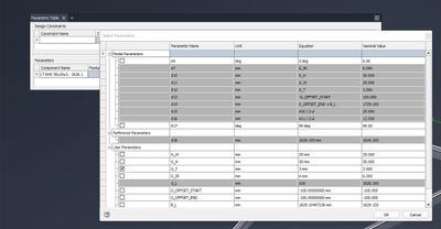

Hi @zaheen.shaikh - You should be able to access the frame-member parameters in a parametric study.
The "Model parameters" are not accessible if they were created by Frame Generator, but scroll down to "User Parameters" where they are defined - this is where you select them.
In this screenshot you can see the Parametric Table in the background showing G_T (wall thickness) is selected.
Peter

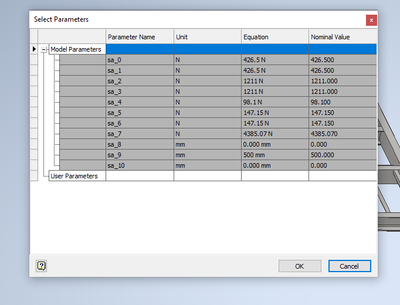

what i am trying to do is, i have selected a channel as you can see in the attached screenshot of dimensions (100 x 50 x 5). i apply load on the respective beams. i get the result. now i want to reduce the size of channels while not compromising with the safety factor. i want to know if instead of (100 x 50 x 5) whether i can use (70 x 40 x 5) or even channels of less size/weight.
as you can see in the attached screenshot, the user parameters contains no values, while model parameters show only the forces that i have applied over the beam channels.
could you please help me with this.

I think you are trying to get to the parameters by right-clicking the assembly.  The assembly is not where the part parameters live.
Try right-clicking the part(s):
