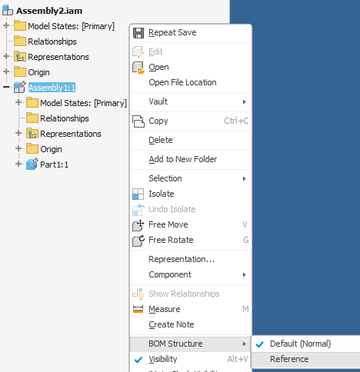

I have part 1 (P1) in assembly 1 (A1), and A1 is a subassembly to A2.
I have been in the past able to set part 1 in assembly 1 as normal, but reference in assembly 2. Currently this option is greyed out.
There are 2 ways to set apart reference:
1. from iProperties (or BOM), which changes the part to reference in all other assemblies it's represented in.
2. from the assembly browser, which only sets that part as reference in the particular assembly.
I am trying to use method 2 as I don't  want to change the part itself. However, in A2 I only have the option to set the subassembly A1 as reference and not part P1. You can see this in below snippets. (items are all checked out and editable)

If I set P1 reference inside A1, then it will still show up as normal when I look at the BOM in A2.
I want P1 to be normal in A1, and reference in A2. This is what I am having issues with, because it was possible previously but now I cannot do it.

Hi there, I think this is because you can only override at the top level, if you want to set that part as reference you need to open assembly 1:1 and override it there.

Or you change the Part1's BOM Structure property in its Doc Settings (open the part -> Tools -> Doc Settings -> BOM -> BOM Structure -> Reference).
Please note that changing it in the Doc Settings means the particular part will be default to Reference wherever it is consumed.
