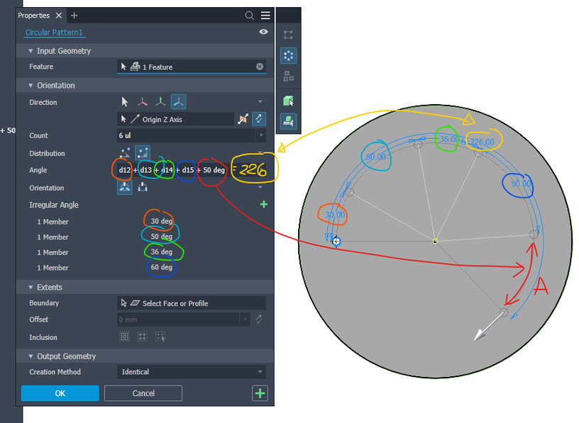

jnowel
@eladm maybe below illustration will help you understand what @kacper.suchomski is saying
The angle in red will be driven dimension based on your existing inputs.
The total angle (226 deg) is a driving dimension.
You cannot specify angle A as another driving dimension like you did in the other angles.
But you can specify it like shown below (where the d12 to d15 are just the parameters created when the circular pattern was created).
