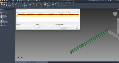

can someone tell me what this is & why this happens.
I have also attached sample files here. please have a look & if there is anything please let me know.

I can't reproduce the issue (no problems from my side), I presume a name comflict as it says.

And the goal is reusing the subassembly, or create new subassemblies?
CCarreiras
CCarreiras
If you set "reuse", you will have several copies of the same sub-assembly, with the same parts.
This is a lot easy to control, have accurate part lists etc.
Note: Sometimes, due geometry specifications, parts can't be reused in a mirrored position, and in those cases it's not possible to use "reuse" and it's created a new mirrored part. In this specific case, all the parts can be reused.
