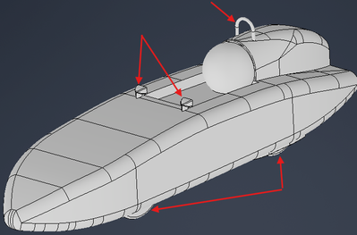

Whenever I attempt to create a shell of this shape it tells me this:
Does anyone have any ideas how to overcome this - as I need to make a shell of this exact shape?

What do you want to Shell?
The Tires?
The Roll Bar?
The Mirrors?
The Body?
What thickness is the Shell? Same for all components of the design?
Are there any unresolved issues indicated in the Browser history?
If you go to the Manage tab and select Rebuild All - are any issues indicated?
Message 3 of 12
D_James25
I want to shell the body, I will add the tires, roll bar and mirrors later which is why there are sketches there for them.
From what I can tell, the unresolved issues are just where the sketches are gonna be used
@D_James25
Then you should Shell the body in history BEFORE the Mirrors, Wheels, Roll Bar are created.

I haven't actually created the mirrors, wheels or roll bar yet, just the sketches so I know where they go when I actually decide to make them - once I've made the shell.
The problem is it won't let me make the shell and gives the error message at the start of the thread.
@D_James25
What do you call these components?
Message 8 of 12
D_James25
oh right in my model it doesn't show that they're there - I may have uploaded the wrong version of the file, my bad.

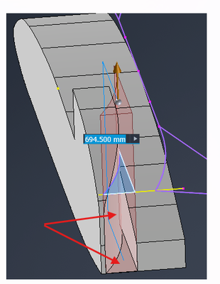

Extrude 4 does not make logical sense.
Message 10 of 12
D_James25
the main reason is it is a drawing imported from illustrator taken from an image so there are many nodes as there were in the drawing.
The extrude is because I needed to have that shape but couldn't extrude to that face as there were multiple faces there so it wouldn't let me (I am relatively new to doing this so don't know all the tips and tricks).
