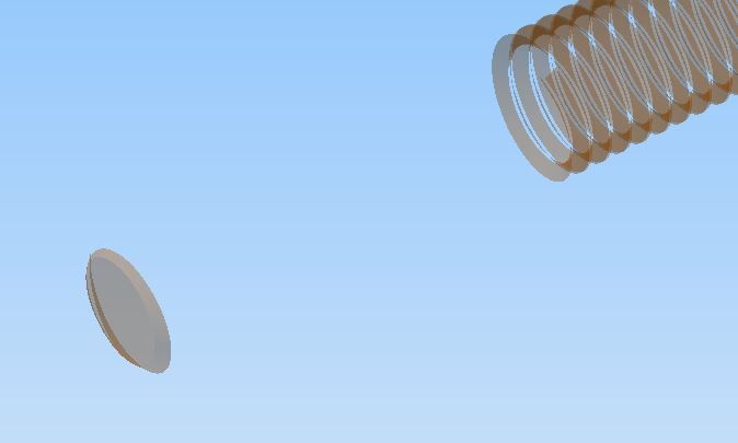

See attached. Original part was imported from this (tried as 3D Solidworks and 3D STEP, both did not work after importing into Inventor 2020.4.2):
https://www.mcmaster.com/1078N33/
Rebuild All and changing materials did not work. When we go into iProperties > Physical > Update, there is no change either.
I also repaired the (overly simple) geometry and also tried unstitching and stitching it back on. Then tried finally to add another feature and delete it, which also failed to make any difference.... ended up having to use a workaround of rebuilding this part from scratch in a new file.
I just wanted to understand if there was something I missed here, or maybe leave this up as a good sample for the Inventor devs to look at. Thank you!

Wow, that is a jacked-up file. Even in 2022 I couldn't get it to update. Looking at the file, it's "construction" seems odd...it shows a single solid body, but it will highlight in sections about 3" long, each.
I can say, unless the mass and inertial properties are absolutely essential, this is one case where we would extrude a rod, and add threads to the outstide of the rod.
I wonder if those helical forms are messing things up?

This is a bug. The geometry checks good. But, the coil face with many turns may be too complicated to compute the volume. There is a simple workaround though. Use Split command and select YZ plane or XZ plane -> check All Faces. After that, the mass can be evaluated.
Many thanks!

Thanks Johnson, nice trick for me to keep in mind too... the only problem is that this workaround requires you to keep that split feature in, you cannot delete it after.

When I need to use threaded components from McMaster Carr, I typically use the Delete Face w/Heal to get rid of the modeled threads.  It is a very quick procedure to perform, though if you want to truly get rid of the extra baggage in the file, you will want to also copy the solid body to the construction environment and back (also not a lengthy procedure).
The same technique also works with other "over-modeled" features from MMC such as knurling.

I downloaded a new copy of the file from McMaster Carr, and tried my Delete Face technique (be sure the Heal box is checked).  Because of the patterned nature of the thread surfaces, I ended up window selecting the whole part (all faces), then deselecting (ctrl-click) the major diameter face and the two end faces along with their chamfers.  This resulted in a cylinder with chamfers.
This threaded rod is just as easily produced by modeling it from scratch, but the technique applies to all kinds of threaded items from MMC.

I am not sure which faces you kept for OD, because the ones I tried did not work. The chamfers are a bit irregular to use somehow:
If I leave just the caps (green checkmark below) and delete/heal 46 faces I get an error, and if I include the next ones (deleting/healing 44 faces) then my resulting geometry does not make sense anymore:
