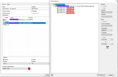

I have a problem with the automatic selection of fittings by Inventor.
Connectors such as elbows do not change according to the selected schedule. When changing the schedule, only the pipe changes, but the elbow is selected first from the list. In my case, it is always schedule 10, because in the table in CC it is the highest. How to change this, or how to create a CC library so that it is set correctly? I have the schedule set under the name "SN". Maybe someone has some step-by-step instructions on how to do this?
In my case, all schedules do not have an "S" at the end.
Should I manually select the right connector with the right schedule with each configuration and know which one has what number? Or do I just have a badly created library?
I am using Inventor Professional 2019

Hello!  During my years of working with Tube & Pipe, I found this same issue to be true.  If a Family in the Content Center contains more than one Schedule, or Material spec, etc... T&P will always default to the one highest in the list.  I'm not sure if this is intentional behavior, or a limitation.  What I did to work around this was simply to limit each family to one Schedule or material.  It does mean more families in the library, but once you have them assigned to a T&P Style, that's not really an issue. Once you have a base Family created, it's just a matter of copying that Family and giving it a new name, and adjusting whatever needs to be adjusted in the values.  That does speed up the process.  It means a bit more setup, but in my opinion, makes things run a bit more smoothly.

With new schedule selected in the style manually selected the elbow by stock number with the correct schedule it can be tricky if your stock number doesn't have the sch anymore. So put the cursor in the new fitt8 g and select ok. As you have found the style filter no longer works so a manual selection is needed. With this approach you can select different schedule and material all from the same family. While C Benner approach of copying family is still good having multiple families to update is a right pain. Another bug in the addin that needs fixing. Some user messages needed to say the schedule doesn't match and how the user should fix this.

That's a lot of libraries. I'm thinking about it, but without macros, I think it will be hard to manage such a Content Center.
Maybe it's crazy, has anyone tried creating styles in an exported .xml file? I've entered the appropriate fittings into the appropriate fields, but piping doesn't create them.

The styles need to be set up manually in the editor one by one for each material/ nominal diameter / sch. Editing the xml style manually likely won't work due to all the CC variables that you might encounter. A tip all of the fittings and pipe need to have a matching schedule and Nominal diameter in there respective family for the style to work. Did selecting the multiple schedules work for you? If it didn't post up some images of where your having difficulty. It works fine in what I'm using which is 2022.

I decided on one family with different materials. I thought to filter by material. However, I can't select the material created, it is not visible (e.g. material : "Stainless Steel 304L, ASTM A312"). Any ideas how I can add the material to the filters?

Does your CC family have this material added? This will create members with this material and allow a unique partnumber and description to be given.
