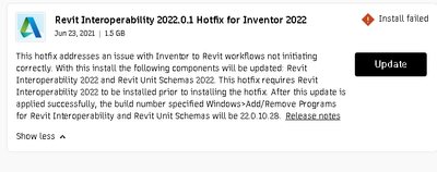

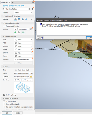

Getting error when trying to export this to RVT shown below.
There is a known fix for this shown below.
The issue is that it says you have to have Revit Interoperability 2022 to be installed prior to installing the hotfix.
Have no idea how to do this or where to find it? Can someone please assist me with this?

Revit Interop is installed by default with Inventor. You can go to Control Panel > Programs and Features > select Inventor > Change, and see if your "Revit Interoperability" is there. You may have to uninstall Inventor and re-install it if you cannot add it through there.

Did check in the control panel and don't have it installed. Reinstalled inventor and didn't see any add on for this in there when doing it. How ever didn't uninstall inventor first. Do I need to fully uninstall inventor for this add in to appear to be downloaded?

Thanks for the links. This didn't work for me at first. Then seen another link off of this where it said sometimes need a fresh install of Inventor. So Uninstalled Inventor completely then reinstalled it. After that it allowed me to do the Revit Interoperability Hotfix Update. After that was installed was able to successfully export a RVT file.
