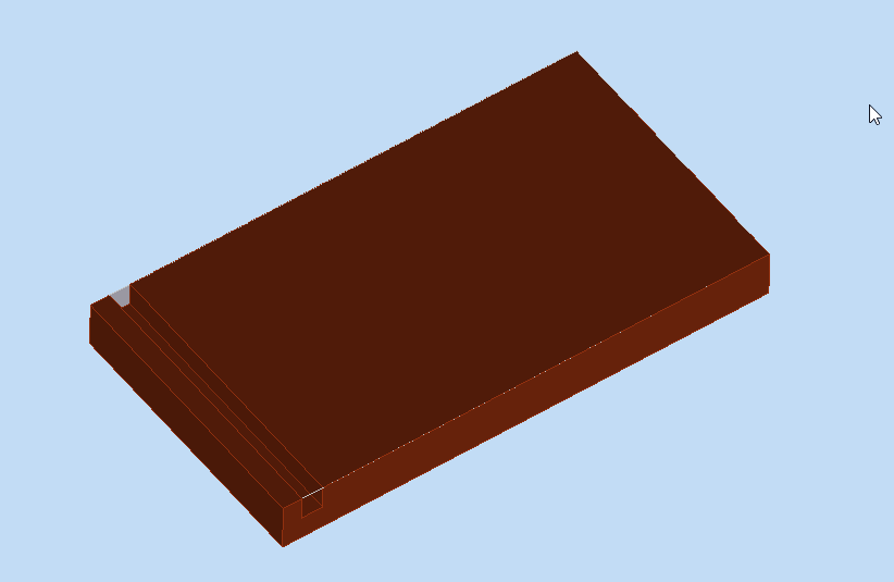

We recently purchased The Product Design & Manufacturing collection for our bespoke woodworking company, however we are struggling to CNC program anything. I was wondering if anyone could help us?
NESTING UTILITY:
- This does outside and inside cuts, but not trenches and rebates. For example; we very often put trenches in the middle of panels between 1 - 20mm deep, but not all the way through the panel. The nesting utility seems geared towards metalwork, and isn't able to do trenches.
HSM CAM:
- The CAM software looks good, but there is no nesting facility (unless you use the above which doesn't work!), and I don't believe its very time efficient CNC programming each individual panel one by one.
We currently work with AutoCAD, and use layers to show the depth of a shape. For example; if we had a trench in the middle of a panel at 5mm deep. We would put it on the "CNC 5mm Deep" layer. Then when we put this in 2D CAM software, we are able to see and select the 5mm trenches, and program them 5mm deep.
I was wondering if anyone had a solution to this issue? The only way we can think of solving this issue is by purchasing 3D CAM software (AlphaCAM), which is roughly £10000!
Any help at all would be much appreciated. I've attached an image to show an example of a panel we would use.

Message 10 of 23
phillip.doup
Hello @jamie.siddons ,
I believe the Nesting Utility already provides you with functionality you can use in the latest version. In this latest version, we introduced more functionality to help with 3D parts. Please have a look at these:
3D representation of input parts
We added visualization controls to show the input parts in 3D in the Nesting Utility:
Here's what that looks like for a part like you're describing:
Larger view to show it along with nested resultsLarger view to show it along with nested results
Zoomed view to show detailZoomed view to show detail
This particular view I'm showing here is the 3D Compare that shows you what the extruded profile looks like along with the original solid model. Granted, this is only in the parts preview above the nests, but it helps show you the 3D model along with the geometry we are using in nesting. Ultimately nesting is a 2D problem, so eventually we end up needing and using a 2D representation of the part. This just helps you compare what we're doing in 2D with the original 3D part, if you have one.
Output to 3D models
Another feature we added in this release makes it possible to generate an assembly containing instances of the original 3D models, if there are any, rather than the solid models created via extrusions it was producing before. What this does is produce a model that has all of the fidelity of the geometry you started with. It doesn't show during the nesting preview in the Nesting Utility because 1) it's a 2D problem, so we're showing you the 2D results and 2) it's a ton of geometry to show on the screen at once for complicated nests and 2D performs much better.
Here's the UI for this export functionality:
For this part above, here's what an example assembly looks like:
image.pngThis model can then be used in CAM directly, allowing you to use the trenches from the original models.
I hope this helps.
