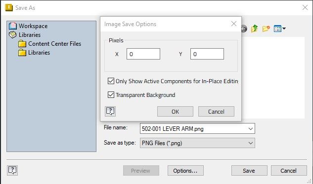

Message 14 of 14
spl1970
Going back to the original question (doesn't answer the question about shadows being captured), unless I'm missing something..
File -> Export -> Image
