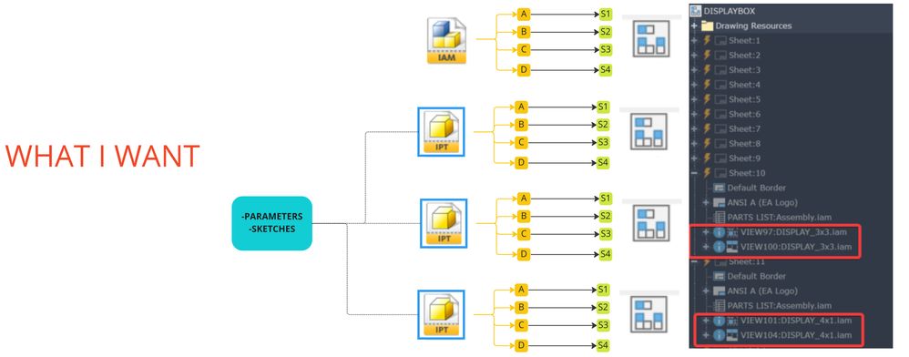

What I want
  1. Have a top level something that I can draw all my parts in together and define in system wide parameters that do not change per configuration (eg wall thickness if everything is from the same material)
  2. Have individual part/assembly files that I can designate which configuration (A, B, C, D in the image below) I want use Model States/iPart/iAssembly
  3. Have drawings for each ipt/iam with multiple sheets showing identical dimensioning for each configuration (eg Config A goes on S1- Sheet 1, B to S2)

 I have watched a lot of videos (1 ,2,3,4,5) and read a few Top-Down design guides (6,7 ,8 )  but have thus far been unsuccessful in finding an effective way of doing what I want. This answer given by @BDCollett here seems to indicate that it is possible to do exactly what I want to be able to do for Attempt 2 below, but I haven't been able to do so. Other answers (eg this by @CCarreiras ) seem to indicate that this kind of task is better suited to iLogic, however as you will see below I have had issues where iLogic works fine in parts/assemblies but trying to get dwgs to show the right geometry does not work. If anyone has any ideas/tips pointers I would greatly appreciate it.

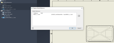

Have you used the Replace Reference Model command in the drawing environment to switch out the model in a drawing view?  I find that can be helpful if the models are related and have similar edges/faces/features.  There is still some manual work, but it can cut down on the tedium.  I'm not sure how well it works if you are swapping out different derived parts. See: https://help.autodesk.com/view/INVNTOR/2023/ENU/?guid=GUID-FC081D92-92AB-4DE0-97B0-72DE7637FAD9

Thanks @swalton, great tips but unfortunately still doesn't solve the issue with having to repeatedly do essentially the same thing.
This wouldn't help for my Attempt 1 as the files are being referenced correctly, just they all provide the same geometry
I didn't use this in my Attempt 2 as when you copy a sheet, it still has the same model reference as the prior. I suppose I could copy the whole drawing and have a separate 1 Sheet drawing for each configuration however this would require more of the manual repetitive work I am trying to avoid.

So this would be similar to my Attempt 1 workflow in that I would
  • Define "configuration" parameters in a master assembly
  • Pass these (via iLogic) to a master part file that has
    • no configurations
    • all the parameters/sketches
  • For the sub-parts either
    • Derive the sketches into separate ipt files and model the solids
    • Model all in the Main ipt and use "Make Components" to separate into separate ipt files
  • Place all individual parts in Main Assy
  • Produce drawings of all parts/assemblies required
@BDCollett  your suggestion is to then
  • Use iLogic Design copy to make new sets of all the above files for each configuration
  • Go into each configuration's drawing files and edit them to include relevant notes, scaling etc
  • If changes are made affecting all configurations then just edit one of these sets of files and delete the rest, then use iLogic Design Copy and re-edit all the drawing files
If this is the only way to do this in IV then I will do it this way, but I feel like if I can manually update the configurations to get the desired result then I should be able to do it using API/iLogic?
Maybe I dont have a thorough enough understanding of the capabilities of iLogic but if you have any other suggestions that can avoid having to recursively make edits I would appreciate your insight.
This is it basically.
