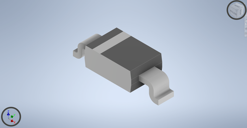

Unsure of the correct terminology, but in Inventor, the top face is set correctly. When I export as a STEP file the left face become the top face as shown below.
I believe this has something to do with the XYZ / coordinate plan that is setup but unsure on how to fix this. Anyone know?

Ignore words like “top” or “front” that is all relative to where you are (imagine you are on the ISS).
Pay attention only to the XYZ.
To reorient relative to XYZ either Redefine Sketch Plane, Direct Edit Rotate or if assembly set to desired planes.
Attach your file(s) here if you can’t figure it out.

Hi! I took a quick look at the STEP file. The part body was designed such that the Y-axis points to the text emboss ("TAN CASE-A"). I assume you would like Z-axis to point to that direction. This has nothing to do with the ViewCube though. It is related how the body geometry is relative to the coordinate system.
In your case, as JD suggested, you need to use Direct Edit -> Body -> Rotate to reorient the body toward the expected direction relative to XYZ.
Redefining ViewCube direction in this part would not help, because STEP only cares about how the geometry is positioned and oriented to the coordinate system, not the ViewCube.
Another change you want to make to avoid the behavior is to change the ViewCube direction in the ipt and iam file. There are quite few threads discussing the procedure to do it. You could search for the topic.
Many thanks!

Hi! In the assembly, it is more flexible. You can easily use assembly constraints to reposition or reorient the parts desirably using assembly constraints or joints.
The template files you created do have Z-axis pointing upward (Top). However, I don't think they will help you export the existing files to the desirable orientation. It is because your issue is with how the part bodies are relative to the origin axes, not how they are oriented against the ViewCube. ViewCube is just like a manipulator to change camera angle. The actual parts stay still in the space.

@johnsonshiue Thanks John and yes you are correct about exporting the current assembly! I got ahead of myself and did not mention my initial question about fixing the orientation for a existing part!
In case others are interested, first opening the assembly and rotating the ViewCube so Z is up.
I set this as the new home view via the ViewCube also for convenience.
As John mentioned, easy way to rotate the object is just to add a mate constraint to the XY plane.
Opening the file in another application, like Fusion 360, also has the correct orientation now.
