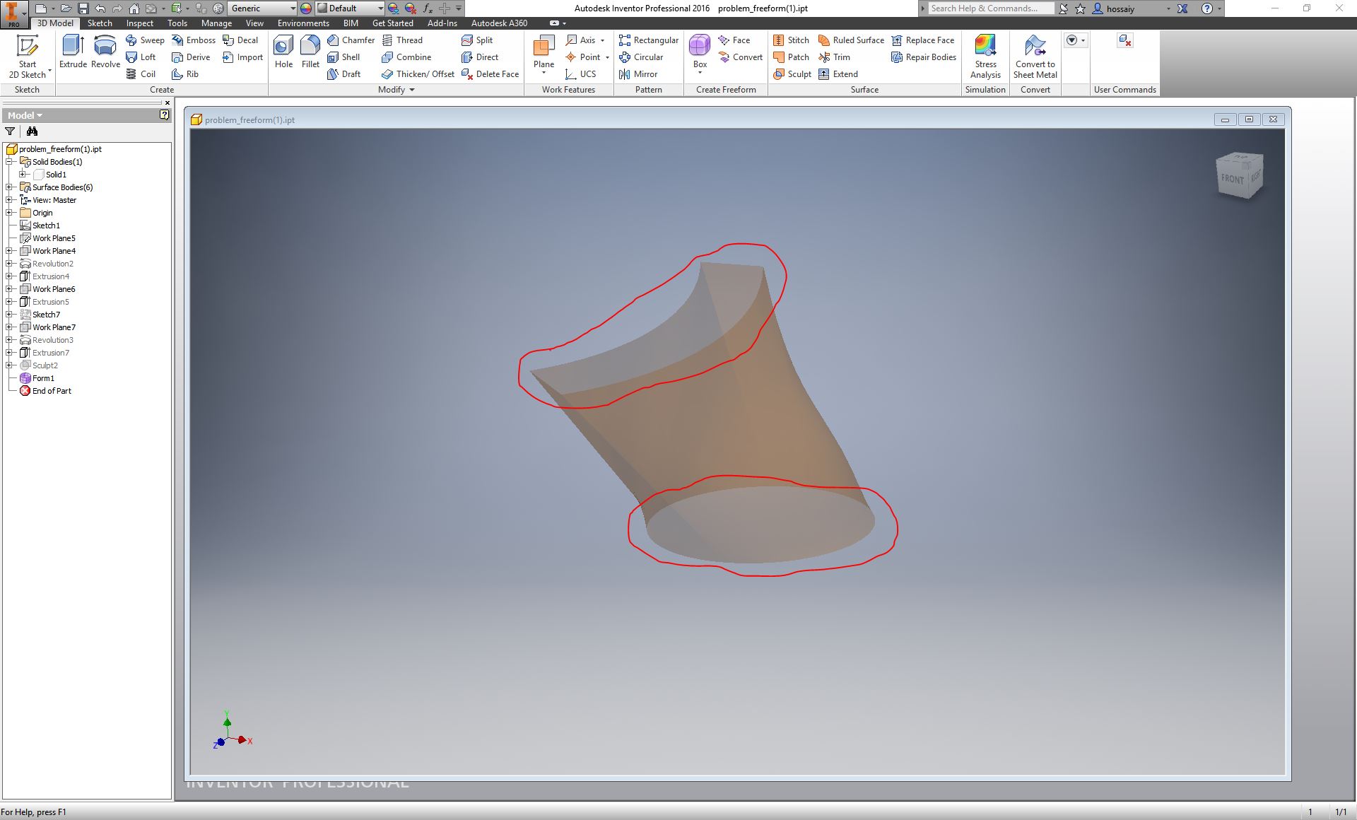

when I try to thick my surface that i created with loft I cant get the green line straight on the circle  >>>   pic attachment below

I'm not sure i understood the intent of the freeform body, but to make it a solid, it must be closed (currently it is an open, see below):
To turn it into a solid, I deleted a couple of faces from the solid body created previously (in the previously attached "problem_a.ipt") and also deleted  "Sculpt1" + LoftSrf2 and then just stitched the remaining faces together to form the new solid (see attached "problem_freeform_b.ipt").
The end result might not be what you were after, but i hope the work-flow at least gives you an idea of how to go from an open surface to a solid body.

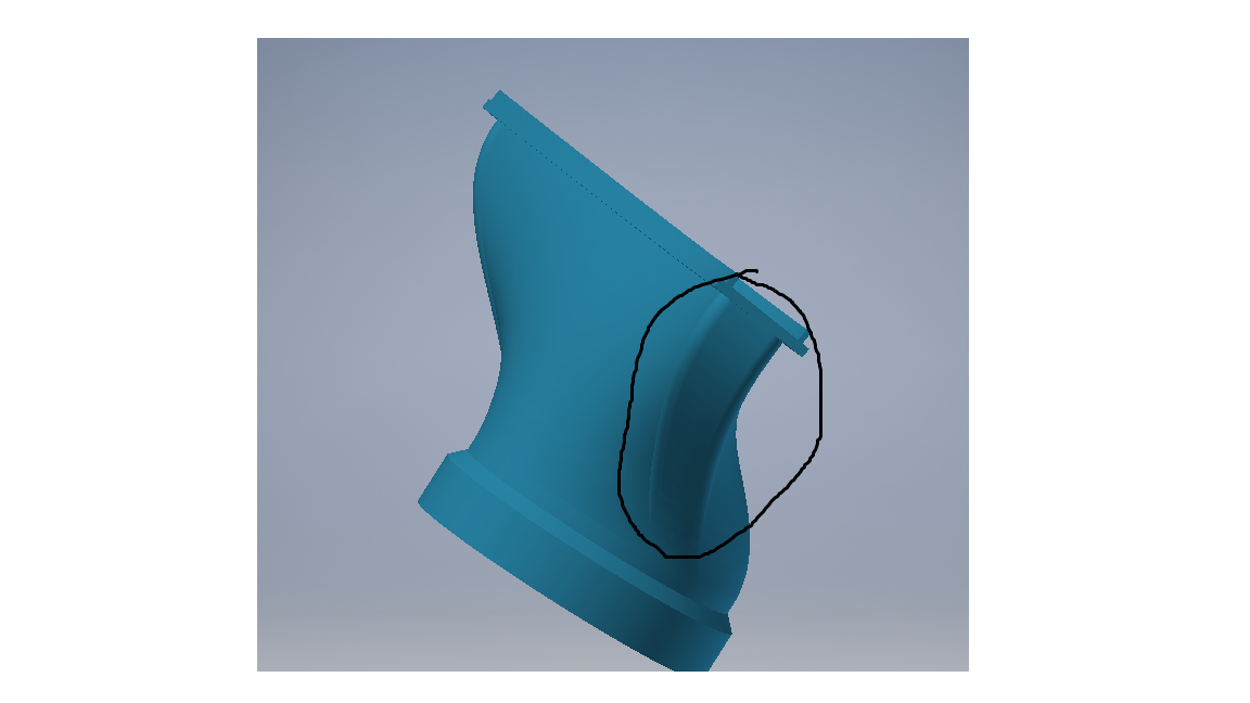

Here are the pictures of the full part.        and also I wanted to know how you used that BOW shape in the front of it.

You can control Tangency condition and "weight" of the Loft feature.
Experiment with the start and end "weight" of the curves.
You can also add Guide Rails.

well I don't have to put the pictures in the sketches, the only thing I need to know how to draw the side shapes in the image below.
the shapes have to be fluent without clear lines as you currently see in the drawing.
