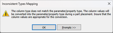

I'm trying to make a column on a custom content center part drive a text parameter in the created part, but it is not working.  I have the text parameter in the part and publish it to the content center, then create a column in my family table and set the data type to string, then in my family properties I map that column to the user text parameter.
It give me the error that the column type does not match the parameter type.
When I generate a part from this family the values are not pushed to the parameter.
Is there something I'm missing here, or is this not possible?

Andrew,
I did some testing, and you cannot drive a text parameter from an iProperty. such as you are exporting the value from your parameter list into an iproperty, this doesn't allow for you to change the iproperty and update the parameter.
Is there a reason you need the text as a parameter? We could map and set up a custom iproerty that would do the same thing.

I understand. that parameter is not changeable inside a CC part. Numeric parameters are changeable. that's why I was asking if you could skip the parameter part of this and just use a custom iproperty. that can house the data. why do you need a text based parameter?
Message 8 of 14
andrewiv
The issue comes from something that was set up in our templates and using parameters exported to iProperties.  After my original post, I did figure out that it works fine if I just drive the iProperty and delete or uncheck export on the parameter.  But I still think it is odd that we cannot drive a text parameter with the CC table.  I am able to get around it but there might be a legitimate reason why we would need the ability to modify a text parameter later.  If they cannot be driven by the table then that should be stated somewhere and it should not allow you to map a column to a text parameter.

johnsonshiue
Hi Andrew,
Indeed, it is not a supported workflow. It was partially due to iPart not supporting text parameter either.
Many thanks!
