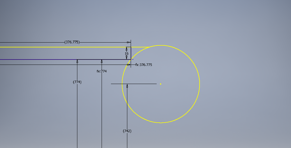

I've actually figured out how to control the tangent constraint. At least for now
My project is to build a fully parameter driven skateboard miniramp/halfpipe design. In about a week about 15 hours worth of work and about 4 throw away part files later I've actually come up with something very reliable.
The concerning point for the tangent was where the deck extended to the coping (circle hollow section). The design concerns get a little bit complicated due to the way the coping can be adjusted but alas for this post all you need to know is that I need a tangent to calculate it.
One thing I observed was how the deck would flip over to the far side of the coping when I adjusted the copings outer diameter more than twice its previous amount. I also observed that it never flipped back.
So with my design I just accepted the flipped version and worked backwards from it. You can see in my screenshots how I strangle the copings OD with a rectangle. So far no matter what I do it'll always calculate correctly.
I intend to put this concept into practice on another place I need a tangent constraint.
I was just about to post a few more screenshots as examples to show how the coping is adjusted in extreme increments but then I noticed "the tangent" was actually flip flopping right to left and back again.
Note: I'm referring to the sketch line and tangent constraint relationship as just "the tangent".
Surprisingly I managed to get "the tangent" to flip back and forth but because the design accepts a flipped tangent it didn't break my design.
In this screenshot you can see "the tangent" gets flipped. But thats okay because it just means it sits on top of the intended edge.
