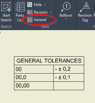

That would be neat in a way, but for that kind of information I'd use the General Table and then use Styles for formatting:
