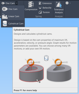

This was written 14 years ago - long before the Cylindrical Cam generator.
Now you can use the Cam Generator - start a new Assembly file and go to Design tab and click down arrow next to Disc Cam to get to Cylindrical Cam.
