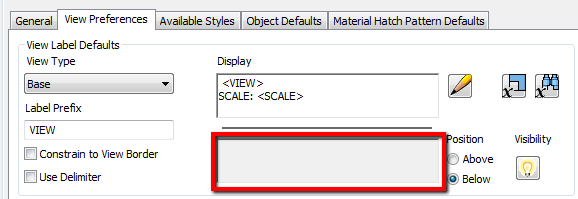

I've been cleaning up our standards in Inventor and noticed an area that looks like a greyed-out text entry field (see below).  Ideally, this would be a second line for a view label so I could use two different fonts.  Can anyone tell me what that area is or what it's for?  Is there somewhere I can find more information on it?  Help didn't have anything on it, that I could see.

Check the Use Delimiter box, then it will be active.
