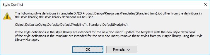

Hi there,
here is what I am experiencing with my standard templates when I switch to anything other than "standard".
I keep updating the style in my templates, and this keeps showing up!!!!
any idea how to resolve this?

Indeed this is not good news. Can you please tell me which update you ran? Can you roll it back?
And you get the same messages? Do you switch projects? Does it happen in all your Inventor projects?
I am so sorry that you run into this again. But if this behavior is reproducible we have to figure out what triggers it.

as far as the update goes, its Build:233,Release: 2017.3 Update - Date : Mon 10/31/2016
in terms of inventor projects, I am using vault, so I only have one project that manages the entire work-space with unique file naming system pushed through vault.
this is puzzling me as well and I totally understand your point to reproduce it and diagnose it from there, but I just dont know how. I can give you a clue and it might help Autodesk team with identifying where the issue is coming from,
if I open my standard(mm).ipt , go to document settings, change units back to "in" and "lb" from "mm" and "kg", save the file and close it, the error message disappears, so whatever it is, units causes that "default modelling" mismatch in style. as soon as I change the units back to metric, it pops up. to be honest with you I cant think of anything else that I have done after we fixed the issue and I also contacted our re seller and let them know.
Having said that, the product is running fine otherwise, I can shut the message up for the session and it wont bug me anymore, but I just wanted to contribute to a have a better , more reliable problem free product in future versions.

johnsonshiue
Hi Guys,
The warning dialog indicates that the some styles stored in the Standard (mm).ipt are different than the same named definitions in Styles Library. Have you shared the template you are using here? If not, please share.
Many thanks!

Mark.Lancaster
@johnsonshiue
I will tell you that I reported this back 2 years ago while assisting a user..  At that time it was thought the issue was related to the templates being located on the user's network and not in the default/standard location.  However we never found a solution and the user redid their Inventor installation since they were switching to a new machine and the issue never returned for them.
