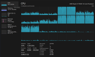

It looks like Inventor is using only 8 of my 32 threads for fea. I was just wondering if there is a way to change that and speed up analysis
johnsonshiue
Hi! I suggest you look into Fusion Simulation, which performs the compute in the cloud. And, you can still work on design in your desktop.
