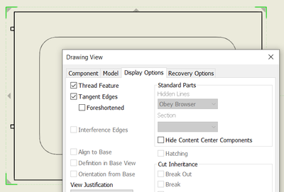

Gabriel_Watson
As JD pointed out, you just need to edit the master view and include Tangent Edges. Because the projection (in this sample) has its style derived from the base view, it will inherit the same change (cannot change on projected views alone that have that option still on).
Result for the sample provided:
tomislav.peran
Yes, perfect. I did not look there at all.
Thank you a lot!
