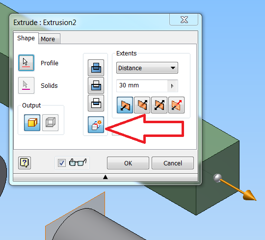

What if you edit Extrusion 2 and select New Solid instead of Join?

Unfortunately, this does not solve the existing problem. Iit can prevent a future problem, assuming I properly anticipate the need to create a new solid, but I need a solution that will convert a single-body drawing to a multi-body drawing.

Revised problem description - I have a solid body that is actually two disjointed bodies.  I would like for them to be two separate solid bodies.  Because of parent/child dependencies - I cannot simply go back in history and edit one of the earlier features and change to New Body.  How can I solve this problem since Split will not work with disjointed solids?
Answer - use a simple Extrusion-Intersection-New Body.
