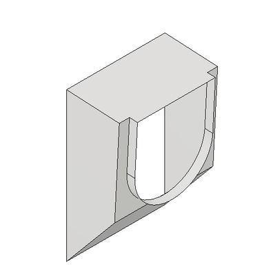

I'm currently designing a chute for a bucket elevator, and normally I would do a surface skeleton and then project faces to make sheet metal pieces.
This chute is kind of hard to do it by extruded surfaces, so I tried to do it solid then convert to surface but couldn't find the way to.
Do you have a solution for this?

I'd try the Delete Face command.  Pick a face that you will leave open in the actual chute.
If you don't like that command, you could use the Thicken/Offset command and a 0.000 offset dimension.

That's not quite what i was looking for but it turned my piece into a surface, so it works.
Take your "accept solution" wise man.

You want to make that form out of sheet metal?  Which side(s) are open?  Can you attach a photo of something similar that already exists?  Can you attach your attempt here?  I suspect there is a relatively easy way to do what you're asking.
Yes, I want to use it as a skeleton to make my sheet metal parts easier.
I don't think that really matters but attached is a picture showing how. As I replied before, deleting faces would make my piece a surface so that was really what I was looking for.
Attached 1. You'll see that there's a surface that I modeled so I can project edges and create sheet metal pieces.
Attached 2

Here is a different way to approach this.  Attached is a 2021 part file containing seven separate solid bodies modeled in sheet metal to make up your assembly.  I do not have time this evening to complete the job by using Make Components to derive the seven solids into seven parts and place them into an assembly.  Just note that when you do so, the parts (and therefore the assembly) will be connected to the master part file, and changes in the master file will change the parts and the assembly.  All the geometry is controlled from the one part file.
