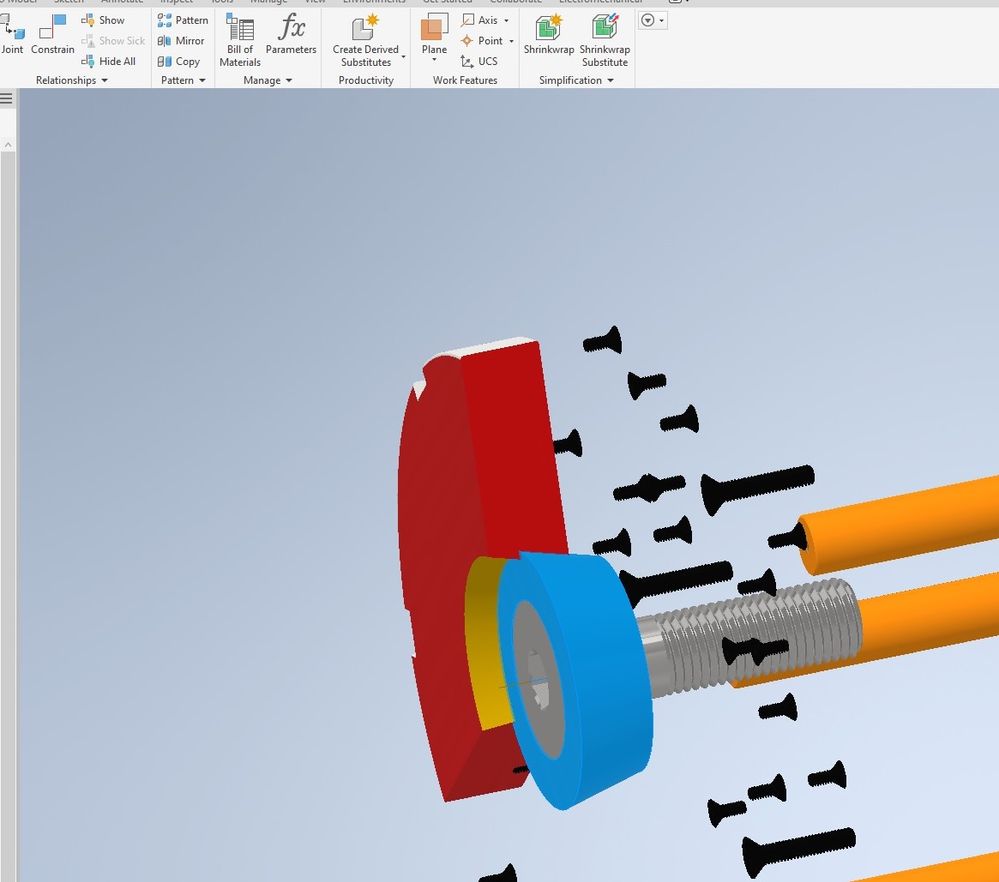

I'm having trouble figuring out how to contrain my "pipe expander".  The turquoise cone shaped part slides against the red shaped die (there are 3 of them, like pie pieces, and the slide outward).  How can I contrain this properly, or am I only able to do this in a dynamic simulation?

this does not help me with motion....I need the parts to slide.
After I use the axis contraint, how can I keep the parts from colliding, as shown in this screenshot?

I need the inner cone to slide, touch the outer cone, and push the outer cone away, with no clearance between the parts

using only a mate constraint will not allow the parts to slide axially aligned.
When I use the suggestions given in this thread, with contact solver & contact set, the parts do not behave as I wish - the inner cone will move until it makes contact with the other, then it will stop.  When I keep moving my mouse, the part suddenly jumps out of contact.  The inner cone will not "push" the outer die up and out of the way as I need it to.

Attached is a screenshot of your solution, which is not what I need.  The cylindrical mate does not allow the relationship I am looking for.  When I change the mate offset, the parts interfere, as this screenshot shows.  I am asking for a solution to allow the blue tapered face to push against the yellow tapered face, with zero interference.  The parts will start out on the same plane & aligned axially, but as soon as the blue cone moves into the yellow face, I want the yellow face to move outward radially, but the faces will have zero clearance.
