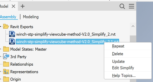

I tried both All in one and Top level Element structure modes to see if the results are any different:
Both of the Resulting RVT files in Revit ended up as a Generic Model that is one solid block which does not allow you to edit it as an object:
So I got a simplified RVT file with this process but I cannot actually change it in anyway which is a similar scenario to the RFA. The RVT file does not appear to be a Group, Assembly or Family. Just some kind of 3D object.
I noticed that you point to the top level model browser for the completed Revit models in Inventor.
I checked it out and it looks like you can try to edit the simplify settings at that point.
Based on the results so far is there a different way to proceed with the RVT or RFA exports so that I can end up with Revit content that is separated into components/parts/families instead of one solid part?
Are there more options in simplify to try out or perhaps even reviewing how to stage the STP file in Inventor from the beginning to make sure all the parts are identified in export?
If I missed anything from your prior post then let me know and I'll go over it again.

With regard to structure. The Inventor model will always come into Revit in one 'Lump'. The structure options allow you to schedule and tag nested sub components, without having to 'explode' the Converted Inventor model inside Revit.

Hi Tadeh,
Here's the workflow I followed to get three separate components in Revit:
  1. Import STEP file into Inventor as a Convert Model
  2. For each major component I created a Model State. (Suppressing the other two components)
  3. Created a Simplified RVT model for each of the model states.
  4. In Revit, Insert tab > Link Revit, select one of the RVT files. Repeat for each model.RVT_output_from_STEP_model.png
    I think this is what you want. It's a few more steps because of the current implementation.
-Bill
