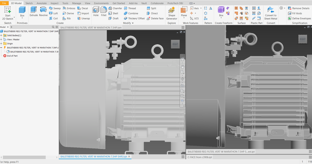

I am using Shrinkwrap on an assembly but getting some strange effects, either surfaces appearing out of nowhere (#1 and inner orange cone) or surfaces that should be included not actually appearing (#2).  Both seem to be based on a C-Face Motor Mount part (light blue in left side assembly).  If I exclude the C-Face both problems disappear.
No matter whether I save the Shrinkwrap as a Single Solid with or without seams, or as a Single Composite, the oddities remain.  If I save the Shrinkwrap maintaining Individual Solids, the surfaces of #2 are shown but the cone in #1 remains.  I have selected to remove all holes and pockets but not remove fillets and chamfers, as well as checked to fill all internal voids and remove internal parts.
I am currently running Inventor 2021.3.1 on Windows 10 Pro, 32 GB RAM.
Any thoughts?  Thanks!

I'd suggest the removing holes, filling voids etc etc is causing it, but it'd be easier to check if you upload your part.

That seems to be it!  If I only select remove holes or only select remove pockets the problems are gone, but choosing both at the same time leads to the strangeness shown.  Thank you!
Message 4 of 8
SharkDesign
I don't know for sure, but it probably uses something similar to delete
face to do it and when you do that manually you sometimes get weird stuff
like that.

Hi! I suspect this is geometry related. Open the assembly and press Ctrl+F7. Is there any bad body reported? If yes, please go through Repair Body workflows to fix the bad geometry.
Please feel free to share the files here. I can take a look and see why the geometry is not properly merged.

I find this sort of thing happens where you remove fillets on a tapered cone that terminates in a radius. It happens when you remove fillets on a hygienic triclamp ferrule - running the taper back to the intersection of the two faces. You should be able to preserve the feature

Nothing happens when I press Ctrl + F7.  Does this only work if there are bad bodies?
I have attached the C-Face .ipt that seems to be the main cause of issues in this assembly.  It is slightly smaller than the one we actually have but is the closest I could find and extract from online models of similar motor assemblies.  I suppose some of the intricate geometry could be the issue.
Finally, when I use a Shrinkwrapped .ipt with missing surfaces (below left) and export to .stp (below right), the surface issues seem to disappear anyway!

Hi! Ctrl+F7 should bring up a dialog showing the body statistics regardless of quality. You may need to add C:\Temp\ folder. Or, clean up %temp% in File Explorer.
I took a quick look at the part. It checks clean. The only thing I did was to move it to Repair Environment, Unstitch, and Restitch at very tight tolerance (0.00001mm). Please try it out and see if it works better.
