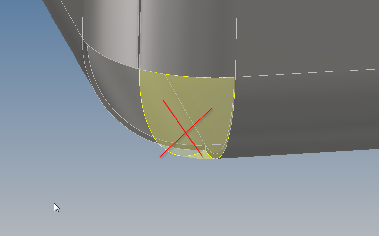

I need a little help.  I am trying to produce a sink bowl that is 6”tall inside x 10” wide inside x 10” wide inside in 20 ga stainless steel sheet.  I need to produce a corner flat pattern that actually represents a 1” radius that can be welded.
Now this was drawn as a non- sheet metal part, then extruded and then shelled to produce the look of the part I need.  I cut a slit in all 4 corners to show that I need this formed.
When trying to do this in sheet metal, I have also tried to use the corner seam command; produced 1” radius’s on each side of the sheet metal and flat patterned the part.  So far so good.  What I am having a problem with is producing an flat pattern that will work for the 1” radius corners at the bottom.
I have attached a pdf of the drawing and 3D pdf so you can get a better idea of my problem.
Any ideas?

Those corner seams require material warping to get to those rounded corners, which can't be easily done with the tools in the sheet metal environment which is based on press brake tools.  My advice would be to take your current part and use the Unfold command under the Modify tab to unfold all of the bends into a flat, then use a Sketch to draw in the corner seams on the flat pattern then use a Face command to fill them in, then do the Refold command, keep in mind this method requires a lot of trial and error, and even then it may not be possible.  I've attached a sample of this method.  Good Luck.

@Anonymous, curved surfaces in two axes can not create inventor in the sheet metal
that would work
2018-09-25 21_33_03-Autodesk Inventor Professional 2019 - [Bauteil1].png2018-09-25 21_33_12-Autodesk Inventor Professional 2019 - [Bauteil1].png

it is no problem to close the corner
but with sheet metal working can not inventor

Hi! Regarding how to create the corner in folded mode, there isn't a change in 2020. Unwrap helps you flatten any non-cylindrical bend (almost any kind of face). But, it does not consider material property or K-factor. It only gives you an approximation of the flattened face.

Inventor 2020 can handle this but the material is not chewing gum, you will get problems with the production.
