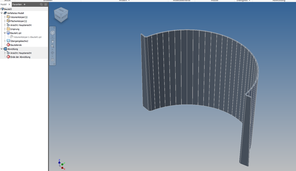

IgorMir
Hi Johnson;
Interestingly enough - Inventor seems to having a problem with that particular design. Here is a quick representation of the OP file. So far - I am struggling to get the shape I want. As can be seen in the file - the Lofted Flange is producing something different to what is expected. Yet a simple Loft is quite happy with the geometry. Except, that at the end of the day I can not get a flat pattern from it, using sheet metal tools.
What's your take on this one?

johnsonshiue
Hi Guys,
These are very good examples. I don't think Sheet Metal Lofted Flange is good at handling sections with change in convexity (concave to convex or vice versa). For this case, the only workaround I can think of is to use Loft Surface instead (remove the fillets) -> Thicken. Then the resultant part may not be unfoldable. You will need to use Unwrap to approximate it.
Unfortunately, there isn't a straight forward workflow to do that at the moment.

JamesSlaven8282
I experienced this issue in 2016 with a similar cone shaped design. It was incredibly frustrating as I thought I was doing something wrong. I finally did get lofted flange to work sufficiently for a reasonable flat pattern. The behavior has remained consistent ever since.
Today I pulled a copy of that old part to retrace my steps for a new design but while editing I lost the lofted flange and then ultimately fatally crashed Inventor. Luckily it was a copy but to date I have spent too much time trying to get the lofted flange to work on a leg-out flanged cone.
I believe my workaround involved the top and bottom arc centers not being on the same origin axis. I also sketched the flanges similarly to the examples earlier in this thread rather then adding flanges later with the flange tool.
Note:
1. Sketching the flanges will result in the Lofted Flange error message
2. Using Lofted Flange on just the top and bottom arc sketches (without flanges) does work but afterwards the flange tool will not create the flanges.
I have never posted on this forum so I hope to receive a ping if someone has a solution and replies.

I spent some time with this again and my results are consistent so I am glad to share the part with some experts.
This file shows five sketched variations of a sheet metal, center-axis quarter cone with flanges. Each sketch pair has a different flange approach... three leg-out and two leg in, with and without sketch fillets.
  • Leg-in version with sketch fillets
    • Required the fillet radius to be greater then the Thickness and even greater yet for an Inside Offset.
    • Press Brake and Die Formed output method works (providing above condition is met)
  • Leg-in without sketch fillets
    • Press Brake and Die Formed both worked unconditionally
  • Leg-out version with fillets
    • Neither Die Formed nor Press Brake output methods worked.
  • The leg-out versions without fillets:
    • Press Brake method works
    • Die Formed does not work
Have a look.
