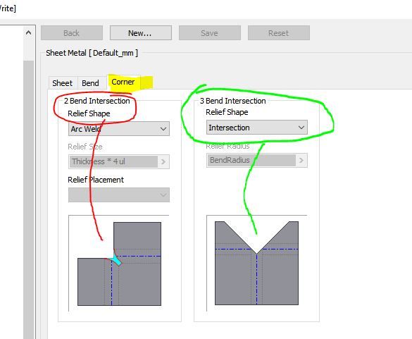

CadManagerMoffatNZ
This is a limitation.
You can only specify arc weld replacement in a "2 bend" corner. ie a flat sheet with 2 bend plates meeting in the corner.
3 bend corners has a much more limited replacement options.
You can see this in the active sheetmetal style corner tab.
