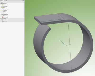

admaiora
This is a sweeped shape

Message 7 of 11
-niels-
@admaiora ah ok, yeah that shape seems to rely heavily on the contour roll to determine where its bends are.
It did not unfold for me and i think it will not unfold if you used the surface-sweep > thicken method either.

Message 9 of 11
CCarreiras
The part is not bended... is a typical press machined.
For the part you post... Well.... a poor workaround to obtain data enough to create a flat pattern:
Anyway, if modeled with sheet metal roll, I believe it will flatten.

Message 11 of 11
johnsonshiue
Hi Matteo,
To unroll a sheet metal part, the roll has to be created by Contour Roll. It is because each CR carries the information that helps unroll operation (Unroll Options, kind of like K factor). A generic shape does not have such model intelligence. As a result, flat pattern will fail.
