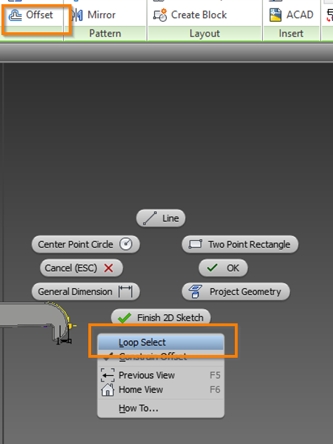

Hi ToddPigg,
After you click the Offset button, right click and make sure the Loop Select option is selected. If that doesn't do it, then you might post an example file for others to have a look at.

- Start the offset command
- Right Click
- Check select loop
- select the loop
will only work if the loop is closed
ToddPig
Perfect. That's what I was looking for. Thanks.
