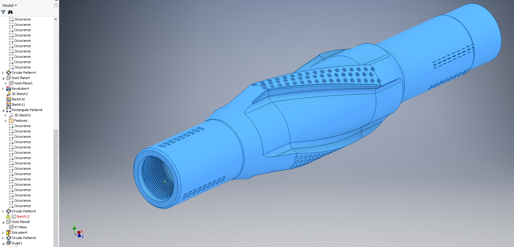

Good Morning
Having an issue with the sculpt command whereby it wont let accept my selection and the ok box remains greyed out.
Any ideas
All services packs and hotfixes have been installed.
Thanks in advance
Jason

Hi
the highlighted part needs to be removed (sculpted from the body) so the main body appears to have a threaded profile.
Jason

ztdservices
I started with the copy object command to add the threaded details to the main body, then selected the sculpt command to removed the selected option. I have done this before and it has worked in the past, hence the reason why I m scratching my head with this just now.

Hochenauer
The OK button is not enabled because your selection does not enclose a volume. It looks like you selected a single planar face. The Sculpt command turns a set of arbitrary intersecting surfaces building a closed volume into a solid.
Does this make sense?
From your description I gather you want to create a shaft with an outside thread where the hole currently is?

ztdservices
the thread is internal (at one end)

Hochenauer
Ok, your input is a solid. I was able to use sculpt after deleting a face from it:
SculptSculpt
For Solids, you can use the Combine command:
combinecombine
I hope this helps.

ztdservices
Thank you very much Gerald 🙂
