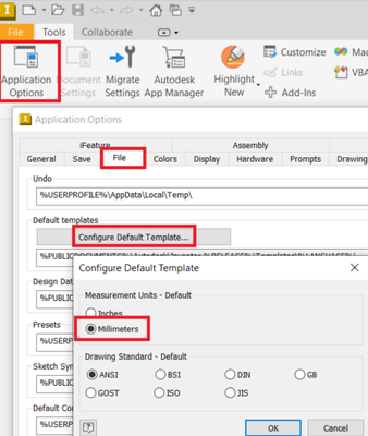

TheCADWhisperer
@kristofszigeti1 wrote:
Starting Inventor, opening a session by the "Part" button, and after that importing
@kristofszigeti1
Stop.
Do you normally work with metric units?
It sounds like your default template is set to inch units.
We can change the default units if you normally work in mm.
But if instead of starting the way you describe, don’t start a New Part. Don’t Import.
Go to File>Open and select Files of Type *.stp and open directly rather than importing into an already open file.
Let me know if you want to change your default units.
Message 14 of 16
JDMather
To Open the *.stp file directly ...
To change Default Template (for all future work)...
To change (or check) the Units of existing work...
