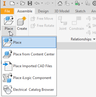

Greetings all,
Maybe someone can help me with the following?
Trying to create a new assembly out of a certain number of *.step files. These step files are already assemblies.
The goal is to save them into one *iam containing several subassemblies and all single parts, to extract the information how many unique single parts are used in all *.step assemblies.
But when saving the *.iam, I have no possibility to affect the *.ipt saving path?
Attached the screenshot of the situation.
Thank you

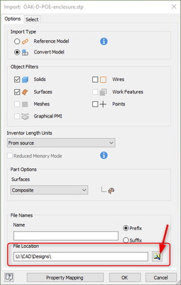

Only input for location i know of when importing STEP files is here:
You have to set that at import.

Hi -niels-
Thanks for the help, yes, this should be the *.step file location, and that would be the location where I want to save all, but for some reason, the *.ipt files are being saved to a location Inventor used for saving some of the previous files (also "decided" by Inventor). I have no influence 😞
