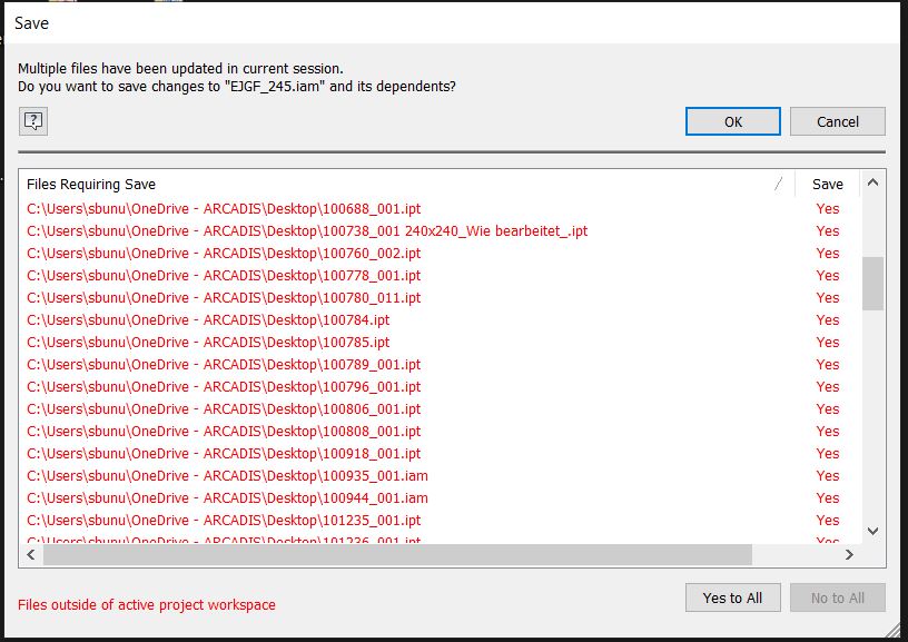

I have a situation when I want to save a step file to Inventor. The situation is the one from the Capture picture. Because of that when I hit the OK button, from the Capture2 picture, all files are saved on my computer.
There is a possibility to skip that step when I want to save that file?

Are you saying you want the step file when saved to remain one single file?  And not create all of the individual files?

My thinking is after this step file is converted, create the derived part using this assembly.
But, with all of that said, I am thinking this is not the solution you are looking for.  Sounds like you want a way to receive a step file in a format that when translated into Inventor is a single file.  The only way to do this is who ever you are getting the step file from, have them make a derived part and export that as a step file.  That would give you what I think you are looking for.

Rather than open the STEP file in Inventor, create a new part file and then Import the STEP file.  In this way all the component parts become separate bodies but all in one part file.

SBix26
Step 1: Create a new part file (.ipt) from your preferred template
Step 2: Click on the Import tool in the Create panel
Step 3: In the Import dialog box, select the STEP file you wish to import
Step 4: Options as desired for the imported part; OK
Step 5: Save the file
Now you have a part file containing the entire STEP assembly, as you wanted.

johnsonshiue
Hi Silviu,
Scott is right. Starting a new part and import the STEP is the way to force an assembly STEP file to become a multi-solid body part. Make sure all geometry types are checked in the Import dialog. If it still does not work, please share the file here. Forum experts can help take a look.
