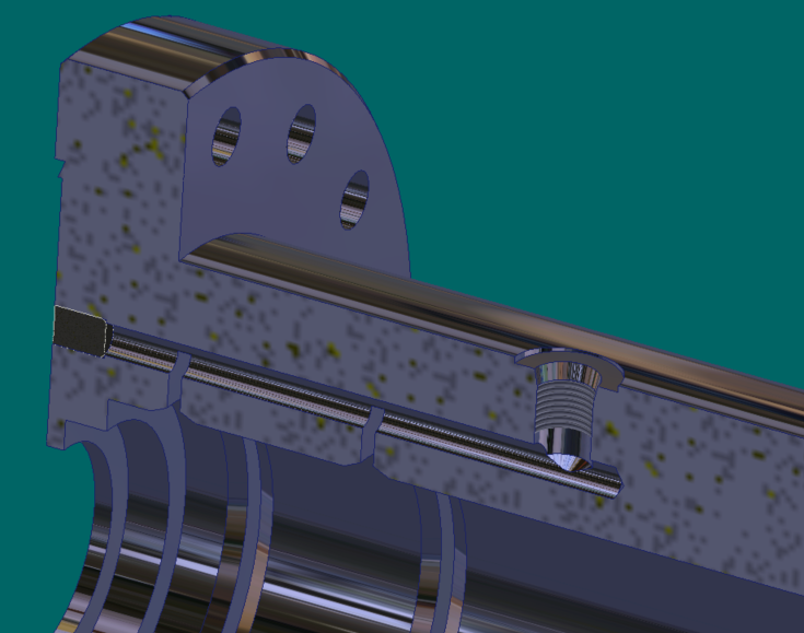

Are there already SAE spec hydraulic hole ports in Inventor 2024? I just upgraded from 2022 and don't see 'em yet. Maybe I don't know where to look, but I REALLY don't want to have to set this up as a custom hole/pocket.
I'm dragging and dropping a hole-pocket spec sheet for all the SAE hydraulic fitting holes.
This'd be immensely helpful...and I'm told that Brand-X already HAS it...
Jeff

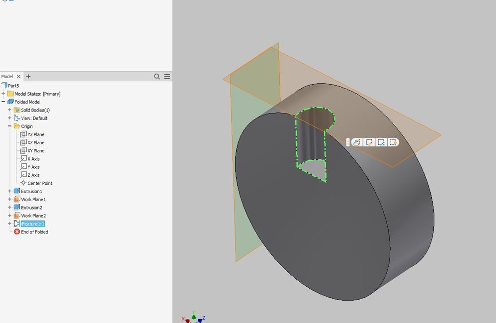

Fred,
Is there a way to add the ifeature to a diameter?  I have a work plane on the outer diameter of a cylinder, with a sketch, but, no matter what i do, it can't build the feature.
Message 5 of 15
Frederick_Law
Yes.
What are you trying to build?

sae portsae port
We use SAE ports all the time, and I just discovered today about the custom ifeature.  I tried to use it but it just doesn't want to work with cylinders.  Currently we just create a tapped spotface hole, then add the chamfers.  I can add the ifeature easily to any flat surface but not on a work plane tangent to a cylinder.

Frederick_Law
Might need different iFeature for flat and cylinder.
It'll depends on the first feature.
Depends on cylinder diameter, the flat will need different depth.

Frederick_Law
It should be doable.
A simple extrude cut iFeature on cylinder.

Frederick_Law
There was no reason to model it.  All was required was a note saying "-8 SAE o-ring port".
Anyway, I tested my SAE port iFeature and it works LOL.
