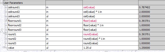

I'm assuming that you've used these functions in previous versions so I'm sorry if these questions come off as trivial but the first thing that comes to mind is: do you have all your unit types in order?
ceil(), floor() and round() only work on unitless values. If this is overlooked, the equation will not parse.
So in other words:
salariua
Units are evaluated before mean value of the parameter so you need to get rid of the units by dividing with “1mm” , process the formula and then multiply by “1mm” like this:
