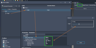

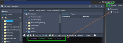

In the assembly:
In parameters chart create The parameter "ANGLE" (select "deg" as unit).
In the part, rename the angle parameter from d1* to "ANGLE" (* as an example... could be other value in your case: d8, d10, d5, etc)
In the assembly, open the iLogic browser and create the rule to connect those parameters (this way, when you change the parameter in assembly environment, it will change in the sketch).
The rule is:
Then, in assembly environment, create a FORM and add the ANGLE variable.
Change the input as SLIDER, instead of Text Box.
Set the minimum and maximum value for the ANGLE value you need to work without causing errors.
Click ok... and now you have a slider to change the ANGLE value and see the result on the fly.
CCarreiras
Message 10 of 10
Inventoruser24
Many thanks for your help, I will try this. Wish you a great day ahead.
