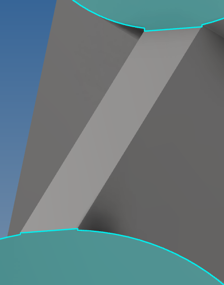

Message 11 of 13
SBix26
Works fine for me, using 2022.3.  All I did was to click the two buttons circled below.
Sam B
Inventor Pro 2023 | Windows 10 Home 21H2
Message 12 of 13
johnsonshiue
Hi Sam,
I don't believe there is a behavioral change here. Your case is different than OP's. The difference is at either end of the Rib sketch. Inventor Rib is a dual-mode feature. It can create Thin Extrusion and also it can extend the profile.
The OP's case is that the Rib sketch line is touching the cylinder at the quadrants. If the protrusion succeeded, it would create unwanted edges as JD illustrated earlier. Imagine extruding a triangular profile in OP's case. Your case does not have such problem. The profile can be merged with the base body nicely. It would work in any release.
Many thanks!
Software Test Engineer
Message 13 of 13
SBix26
Sorry, Johnson, my case can't be different from the OP's because I used the OP's file without modification.  I simply clicked the Rib tool and changed those two options from the defaults.  Yes, it creates unwanted edges (see below) and I would not model a part this way.  However, I am attempting to show the OP that the Rib tool does function with the geometry that they provided in their file.
