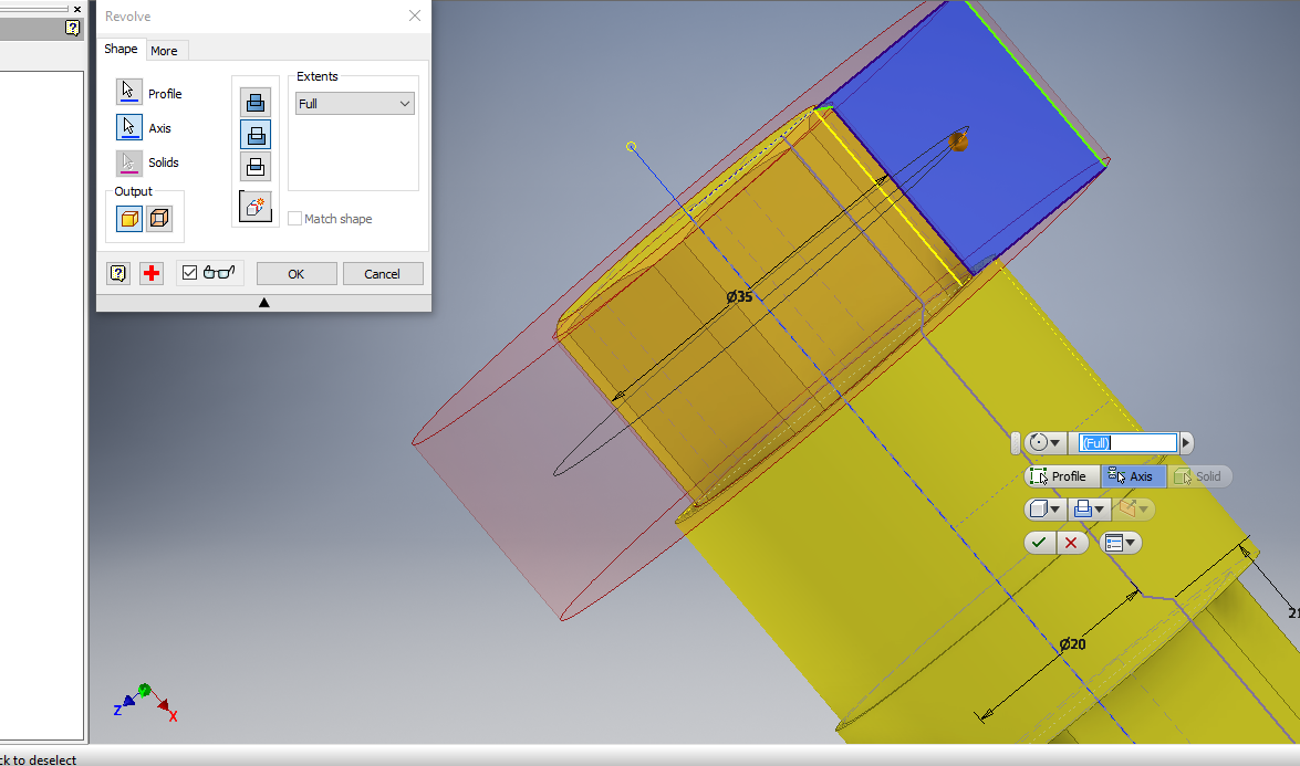

Hi!
I need to create revolve,
but something wrong with the frame.
If I draw it from scratch it works,
but I want to understand what is wrong with this one.
Thank you in advance,
The file is attached

I_Forge_KC
There is a constraint issue with the short leg. If you try to use "close loop" on that geometry you discover that there are duplicate points at your sharp point there. Unfortunately, because it is placed on reference geometry you'll struggle to fix it using the "close loop" command.
If you delete the short leg and then redraw it, it appears to correct the problem (on my side anyway).

mdavis22569
Delete and redo the little angle line...

mdavis22569
also share the exercise that you're working on ... as JD showed you the way it should look. I just fixed what you had shown ( Doesn't mean it's right, it just extruded). I don't know what you're end result is ... but I'm betting it's like his ...

mdavis22569
Ok ...so I was actually right they want to take some off the outside of the hex too...
but we wouldn't know that it was a valve till we saw this ...
