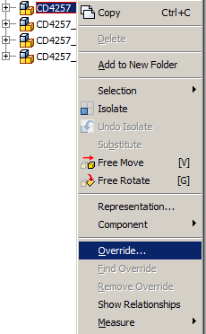

Please see image for INV-2013
When i RMB click on the Sub-assembly i cannot select any Position Rep. It is grayed out. I cannot select any Position Rep for this Sub-Assembly

I think the problem is that you are trying to change a sub-sub-assembly.  You cannot change the positional rep for an assembly two levels deep.  You must create a positional rep in the sub-assembly and set the sub-sub-assembly to the correct positional rep, then when you are in the top assembly and set the sub-assembly to the correct positional rep the sub-sub-assembly will go into the correct position.

You can set PosRep in the assembly itself. It comes in 2 flavours : between components and in representations of the sub-assy.
The first one you have clearly found. You can modify distances or change relations when you create a PosRep. Master set of relations stays alive.
Second flavor is to override the representation of a sub-assy. First step is to actually "override". Select the assy in the browser, right-click, choose override. Panel shows up next where you can set everything. The top list shows the PosReps you have defined. Below you can tick the "positional representation" box. When it's active you can choose between the representations that are present in the given assembly.
See pics.

Check : you must be in a positional representation in the basic assembly file in order to be able to check "override". When you are in 'master' then everything is master.

The reason you don't have the option to override the positional rep is because you are trying to override the sub-assembly and it does not have any positional reps other than master.  You are correct in your previous question that if your sub-sub-assembly has 20 positional reps and you want to be able to use all of them in your top level assembly then you have to create 20 positional reps in your sub-assembly.  Just open the sub-assembly, make the necessary positional reps and override the sub-sub-assembly in each of them to be what you want.  Again, with positional reps you can only override one level deep so if you want assemlbies to change that are two or three levels deep you have to make positional reps in each level until you get to the assembly that you want to change.
