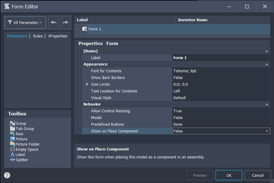

I'd like to know if it possible to replace that standard (auto-composed table showing all key parameters) form with one of the build-in iLogic-forms on use of "Place iLogic Component" command?

Yes. Edit the form and change the 3rd edit field from the bottom.

Could you please be a bit more precise, what is the name  of the field?

I don't know the English name. In the form properties area there is an entry to enable/disable showing the form when inserting a component.

I believe you mean 'Show on Place Component' which is the last of the 'Behavior' (last) section within form properties:

Yes.
The interface may have been changed during an update. You didn't mention what version you are using.
