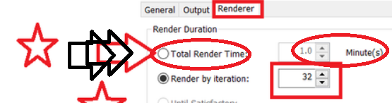

Those are not the parameters that I was interested in influencing the time to Render.
In particular the Frame Rate and the Render Duration (time or iterations per slide) are the parameters that I would examine if you had attached your file here.

Oh wait a minute.  You left it on 32 iterations per frame.
In my previous response I starred the Total Render Time?
What happens if you reduce that time?
Set it to 10 minutes.
How long does it take to Render?
Set it to 5 minutes.

render time:50 sec
and the quality is too badSmiley Frustrated
Message 9 of 13
mojtaba77f
for 5 minuses it was 5 minuses
and for 10 minuses it was 10 minuses
Message 10 of 13
