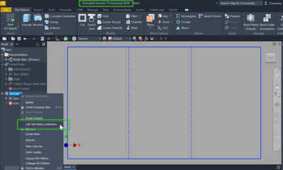

Hi!
The option is still there in 2026:
Actually, is the same option to every version...
Reboot your system an d try again...

CCarreiras
Using your file and 2026 version, the option is available:
If this is the orientation you need, Check the part attached.
